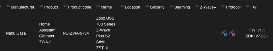

      @therealdb I just bought and installed the ZWA-2. You are right, the setup was easiest thing I've done in ages. Of concern was the fact that ZWJS-UI in Home Assistant shows the correct name, etc. but somehow references my old Zooz details.
      Very odd.
      But it seems to be performing fine - I'm slowly moving things over to it from my Hubitat C7 which seems not able to keep itself together of late. Huge delays, switches literally stuttering, etc.
        Very odd.
        @gwp1 I think you could just rename it
