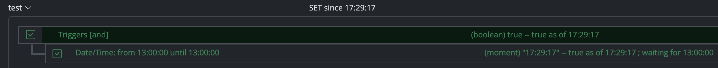

                                @toggledbits remote.send_code has no input field.
                                As shown in above image
                                  Whoops! I'll have that fixed in the next build. Remind me what package you are using (docker or bare metal, RPi, Linux, Windows?)
                                  Edit: And the builds are up (latest).
