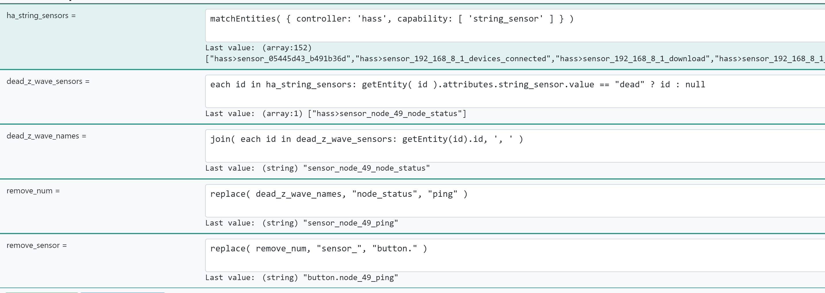

    Hey Patrick, now that I know I cannot use expressions in the data section of service calls I have plans to use a input_text helper in HA where I can fill in the expression result and then use the text in there to invoke certain actions. Currently MSR doesn't support an input_text entity, would be great if this could be added!
    An example of this use case would be as follows:
    I have a bunch of expressions to identify which one of my z wave nodes is dead (a bug in 700 series sticks) and then ping its associated button in HA.
    Using the result of the remove_sensor expression, I would fill a input_text entity then using a service call that looks something like this YAML trigger a button press of the associated ping sensor.

      @pabla said in Input Text Support for Home Assistant:
      It doesn't? That's news to me...
      ...and it has its own set_value action, so no need for the generic call_service...
        Ha yeaup actions weren’t showing up until I restarted reactor
          This restriction has been lifted in build 22251.
