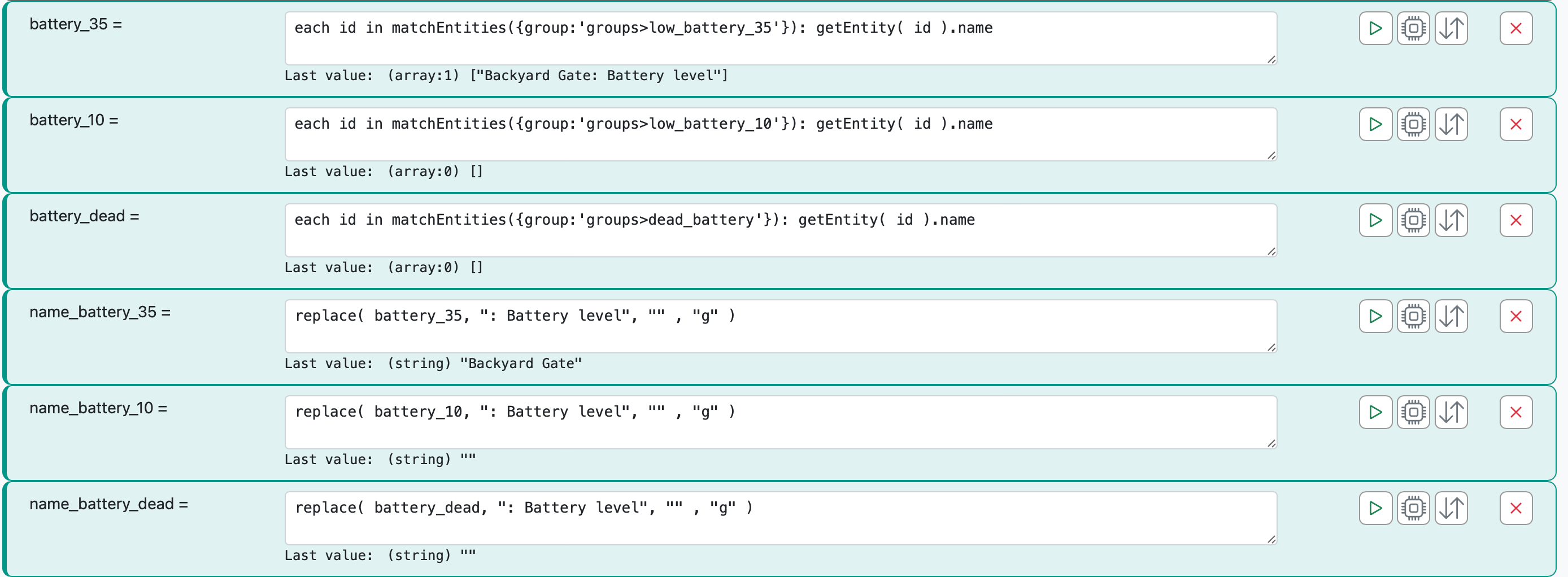

    I have created 3 dynamic groups, the first group called "battery_35" filters all battery_powered devices that have a battery_level between 11% and 35%. My second dynamic group is called "battery_10" and it filters the same type of devices but only the ones with a battery_level between 1% and 10%. The third group is "battery_dead" and filters the same type of devices as the previous groups, but only the ones that have 0% battery. Refer to my earlier thread about the specifics of the dynamic group if necessary.

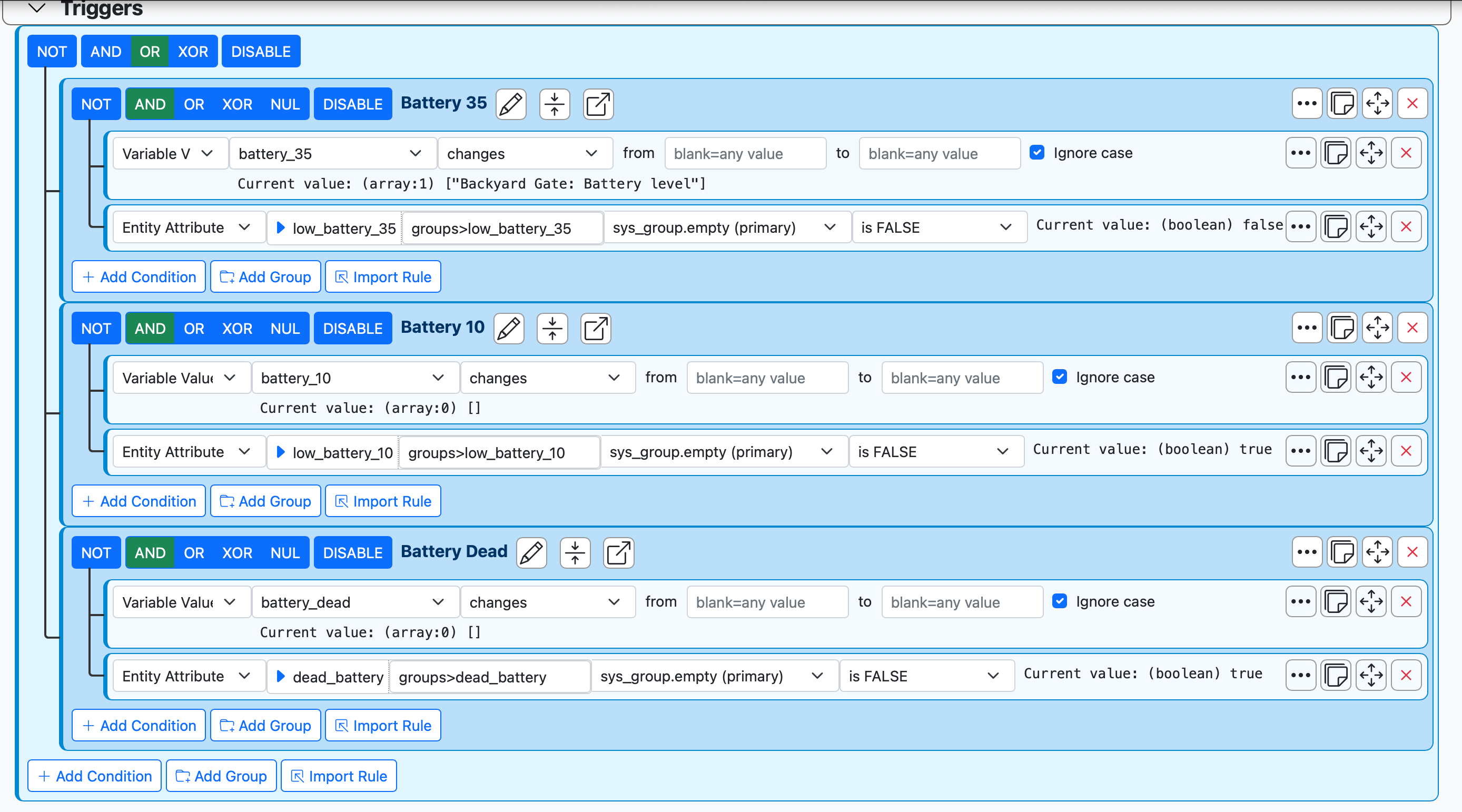

    My triggers are as follow in the screenshot. Basically if the local expression that spits out the devices that match the criteria for one of three dynamic groups changes and the respective dynamic group is false, the rule goes true.

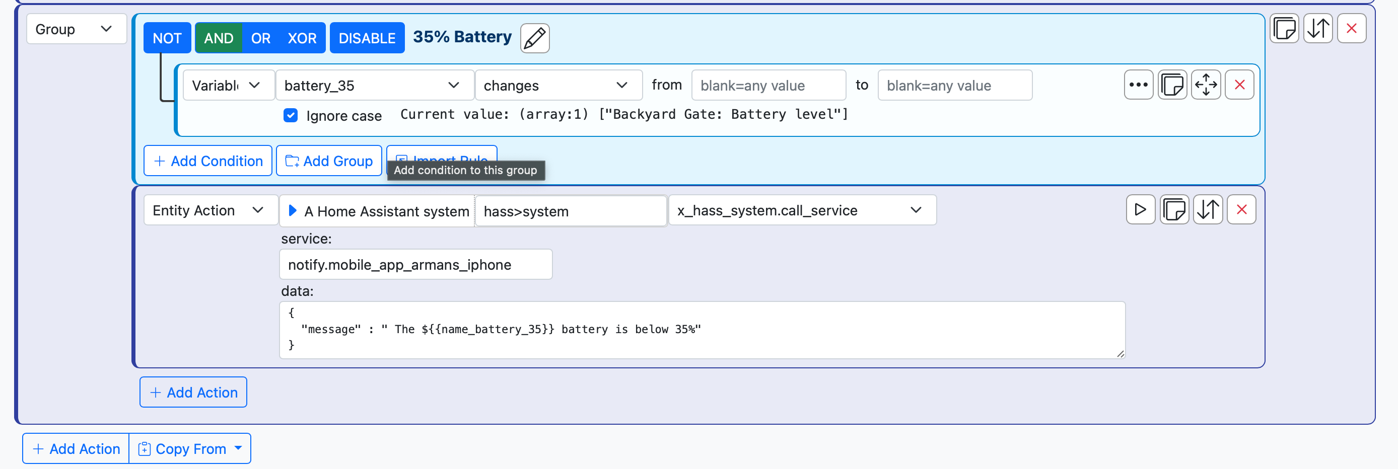

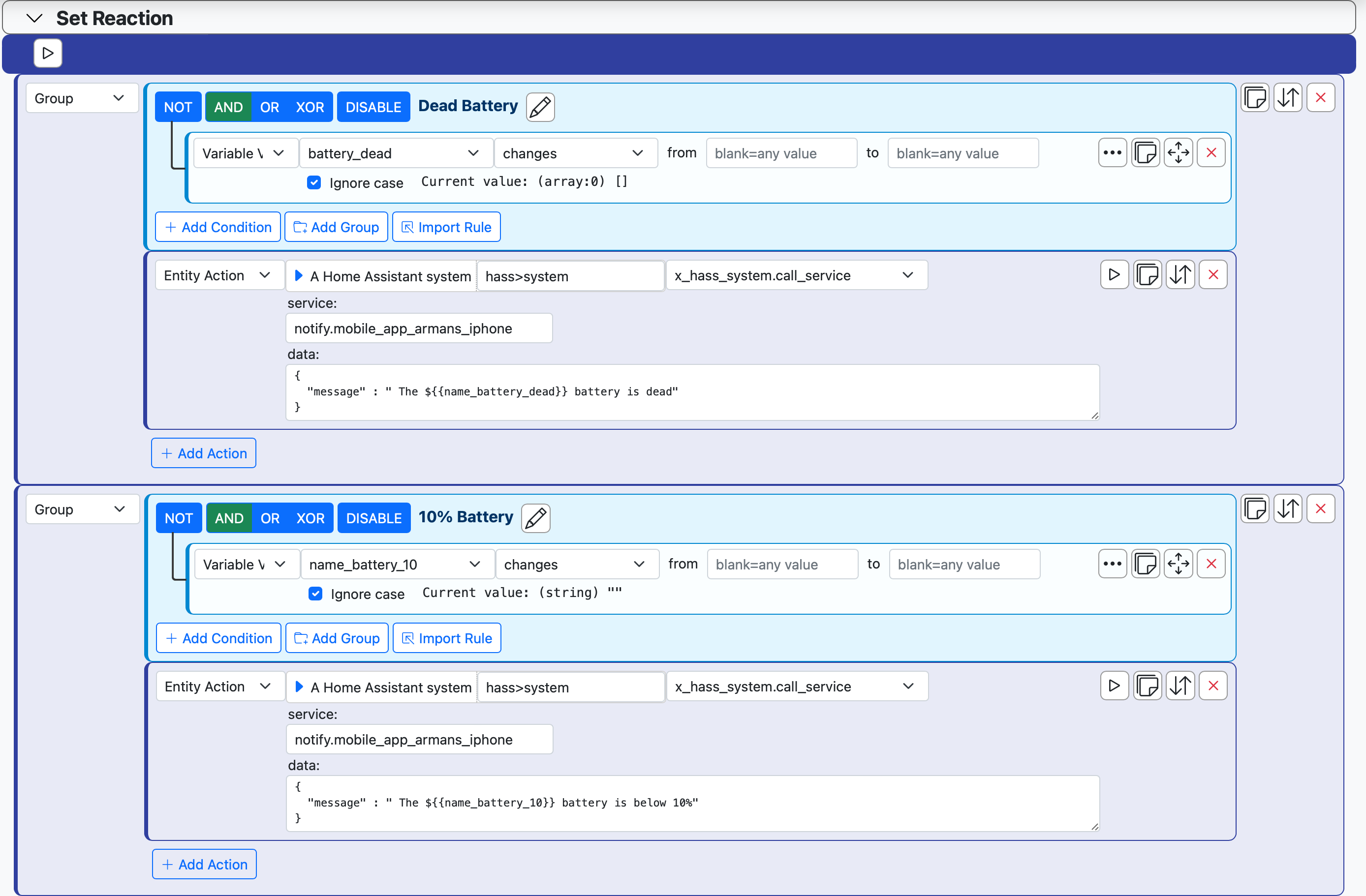

    I have 3 reaction groups, all set up basically the same. I have a condition for each group to only trigger the notify action if the variable that contains the low battery device (either 35%, 10% or dead) changes. I have it set this way to prevent multiple notifications of device low battery and to mitigate the need to create 3 different rulesets for each battery level.
    Screenshot 2022-10-31 at 8.36.40 PM.png Screenshot 2022-10-31 at 8.37.05 PM.png Screenshot 2022-10-31 at 8.38.44 PM.png
    The issue occurs here, if say the "name_battery_10" and/or "name_battery_dead" are empty, and the "name_battery_35" changes (ie a device battery is now between 11-35%) the "35% Battery" successfully (and expectedly) triggers and the notification is sent. However at the same time one of the triggers "name_battery_10" or "name_battery_dead" trigger and those notifications are sent, albeit with empty device names since no devices actually met their filters (haven't found a pattern of which trigger group goes triggers). This only happens if the variable values are empty. If all the variables are not empty I do not experience this issue.

      There's a bug here, but probably not what you think: the changes operator should not be allowed in constraints. It's special, in that it's a reactive operator that can only respond once and immediately when a value changes. After it has declared that a value has changed, that test will not succeed again unless and until the value changes again, so its behavior in a constraint is effectively undefined and nondeterministic. Fixed: next build the changes operator will not be listed as an option in constraint context.
      Instead of using changes again on your group, why not just test to see if your name list is empty/blank or not?
      The group expression errors showing in the log suggest you have a battery-operated device (or whatever matches your selectors) that isn't from Hass (i.e. the x_hass capability isn't present on it). You may need to handle this condition in your expression, which may be as simple as using the coalesce operators in your expression so that a missing attribute doesn't generate an error:
      entity.attributes.x_hass?.state == 'unknown' ||  entity.attributes.x_hass?.state == 'unavailable' || entity.attributes.x_hass?.state == 'none'

        Sounds good, I was pulling my hair out trying to figure out what was wrong. I swapped it for "is not empty" now it triggers as expected.
        This seems to have done the trick as well.
