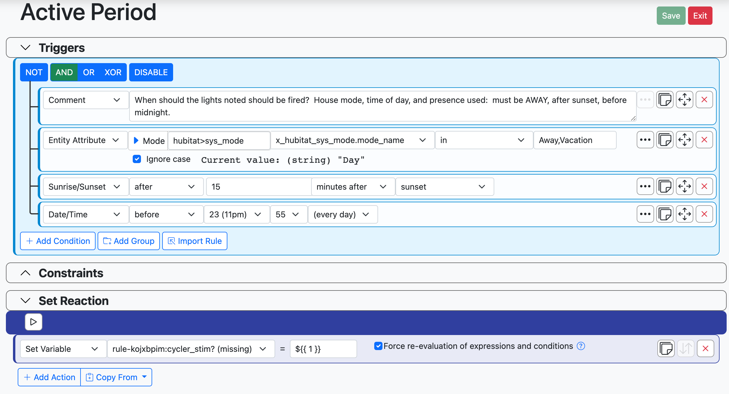

    @toggledbits was looking thru rule sets and updating which (new) lights I wanted REMII to impact and saw that this...
    ...is showing as (missing) in the rule Deactivatedand looking in the dropdown of Variables it appears I cannot select that local expression (only Global) as I did when originally building this out back in 2021.
    In looking at the rule Active Period I'm seeing:
    487074ef-3bfa-4a84-b03d-ed6d920c118c-image.png which appears to be pointing to setting a variable in a rule?
    It's admittedly been a couple years since this was built and it's def not fresh in my memory.
      You didn't show the local expressions?
        @toggledbits I guess that's the problem: there are only Global expressions selectable. Looking thru the rules:
        15189579-1ed6-4fff-9259-5750396878ef-image.png 7e4615fc-2621-40e8-a9c8-2abee0e1075b-image.png
          Back in mid-2021 there were a bunch of changes to variable evaluation and the rules around that, and among them, a rule cannot set or examine a local variable in another rule. I suspect you're just noticing the effect of that here. The engine still runs those rules, but you cannot edit them and leave them in that condition. The shared variable needs to be moved to global scope.
            @toggledbits I suspected that might be the case (something changed). Of course, I've poked at the Deactivated rule this morning so I've probably broken things now.
            I'm guessing I need to convert any Local expression "sets" to Global to fix this?
              @gwp1 said in Reactor Ex Machina:
              Not all, just the ones that referred to from other rules.

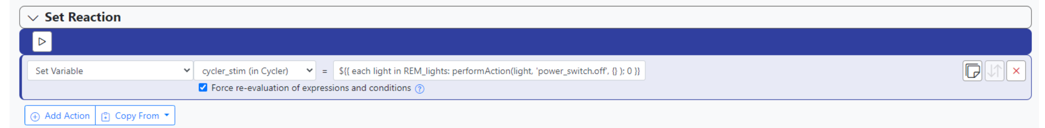

                          @retireditguy said in Reactor Ex Machina:
                          I suspect there may be something wrong with the execution of the statement {{ each light in REM_Lights: performAction( light, 'power_switch.off' , { } ) : 0 }}
                          The expression you show is incorrect -- where you have a colon (:) at the end of the each subexpression (after the closing paren of performAction()) should be a semicolon (;), like this:
                          ${{ each light in REM_lights: performAction( light, 'power_switch.off', {} ); 0 }}

                            @toggledbits Not gonna lie, you made me go squint at mine just to be sure.

                              The reset code bit, hard to read/copy from screenshot:
