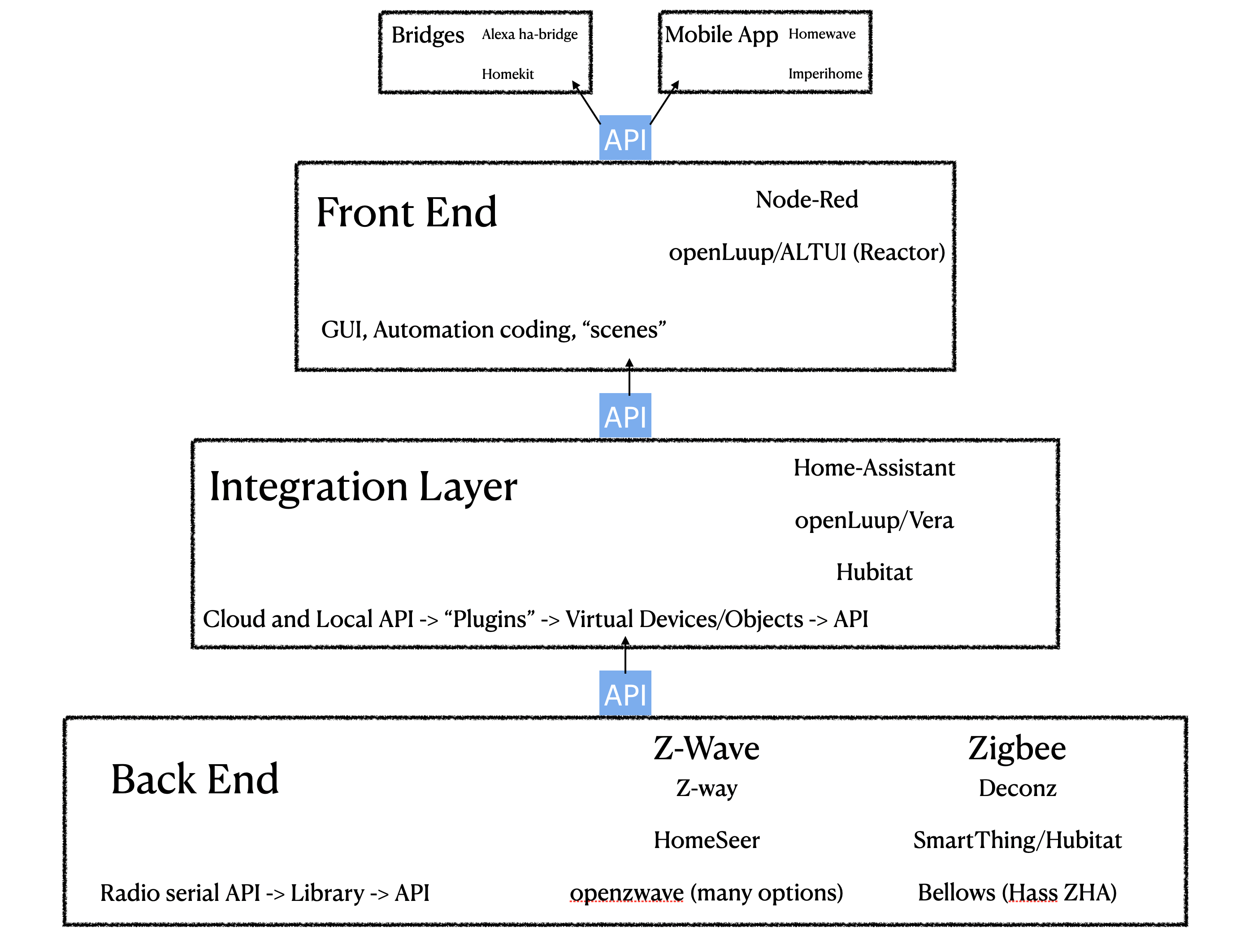

              Hi @rafale77,
              Thanks for the diagram, it's helpful. But can you maybe tell me some more on the integration of Hubitat and Openluup? What is the best way to do it? I'm considering the move away from Vera, but don't know what to choose yet, Zway or Hubitat. Zway seems an easier migration, but Hubitat seems a great and easy all-in solution.
                #29
                Hubitat will give you access to both zigbee and zwave but there is no bridge for it on openluup. This would mean that you would have to start everything from scratch and redo all of your home automation and go through a new learning curve. I have a few friends who run it and are reasonably happy with it. It isn't without its own minor quirks and is a relatively closed environment. It definitely isn't open source. A number of users have integrated it with home assistant to overcome some of its limitations and then used node-red on top for full control (thus completing the pyramid)
                If you have devoted a lot your time developing your system, on vera then you are much better off with openLuup/ z-way which has very little learning curve except for the initial installation, which is more linux learning than anything, offers more flexibility and allows you to migrate all your scenes and plugins over to openLuup.

                  #30
                  I have all my logic in openluup already, so z-way would indeed be the easy route. I also like that it is opensource. The only reason to choose Hubitat would be to simplify things. Thanks for your answer.
                    #31
                    Yeah then it is a no brainer for your use case. We are also all here to help in case you need anything. I can't say enough to describe how happy I have been with the outcome of the migration.
