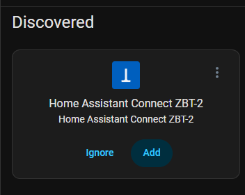

      I have this Home Assistant ZBT-2 in one house, and SONOFF ZBDongle-E in another and both are working OK with Zigbee2MQTT. Mostly plug&play (just the setup is not very straightforward - but manageable), definitely good after setup.

          @CatmanV2 yes. you could use it directly or via Zigbee2MQTT, as I did (because I wanted to fiddle around).
          Home Assistant Connect ZBT-2
          The easiest way to start with Zigbee or Thread is now even better.

              if you connect to HAOS VM, there's no need to install Zigbee2MQTT.
              This should be recognized by HAOS as well. Otherwise, map the USB to your Zigbee2MQTT VM/Docker image and you're good to go. Remember to get an USB cable, so the radio is not near the internal USB port - that's better in terms of radio.
