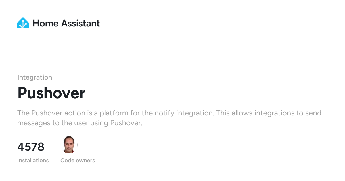

                @RHCPNG
                I am actually using this:
                Pushover
                Pushover
                Instructions on how to add Pushover notifications to Home Assistant.
                and have binded home-assistant and openLuup together through a number of scenes. I use lua code in scenes of openluup to send commands to the home-assistant API which then sends the notification just like I do a number of other things (for example my zigbee network is managed by home-assistant but commanded by openLuup scenes). I posted here how:
                https://smarthome.community/topic/39/lua-function-in-openluup-startup-lua-to-send-async-command-to-home-assistant-api
                I then have another function defined in my startup lua:
                function sendnotif(mess,prio)
                local json = require "rapidjson"
                local a = mess
                local b = prio
                local payl = {
                    message = a,
                    data = {
                        priority = b},
                    title = "OpenLuup"
                local payload = json.encode (payl)
                local path = "http://IP:8123/api/services/notify/pushover"
                POSTH(path, payload, hass_token)
                end
                And call this function in my scene any time I need a notification.
                I do not use zoneminder. I am just using home assistant's camera component to take a snapshot, and send it. In this case, I created an "automation in home assistant and call it from a startup lua function in openLuup.
