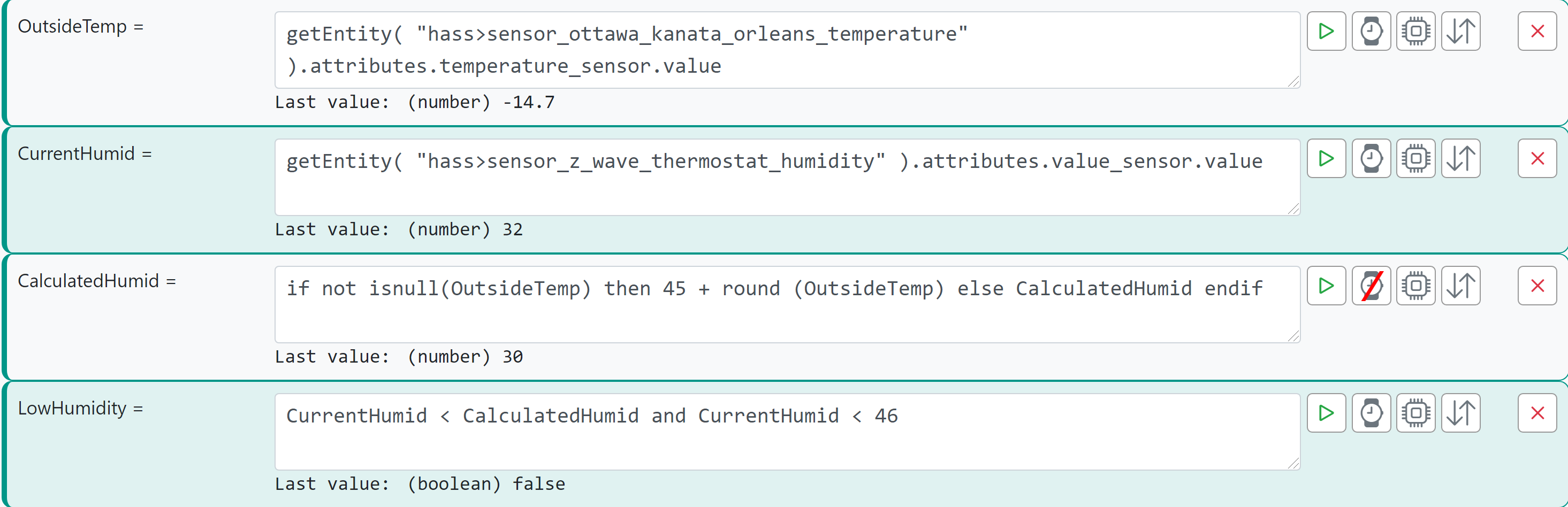

    Hi, I am not a software developper so I apologise in advance...
    MSR 20002 Docker on Raspberry PI 4
    I am using MSR and global expressions to control my house humidifier. To calculate the target humidity level, the outside temperature is used within a simple formula.
    From time to time and for short period, the outside temperature, coming from a Hass sensor is showing a value "null" which is screwing up my target level. Ideally, I would like to retain the current value when the OutsideTemp is not available (i.e. null)
    Here are my global expressions to perform this:
    OutsideTemp: Simply get the outside temperature (that is the one showing "null" from time to time.
    CurrentHumid: Current house humidity
    CalculatedHumid: This is where the target humidity is calculated. (Used to be 45 + round(OutsideTemp)
    LowHumidity: This is the flag that tell the humidifier to start working.
    CalculatedHumid and LowHumid are use in a rule to update sensor in HASS.
    In addiditon LowHumidity is used in 2 rules to turn the Humidifier on and off.
    At first, I was crashing MSR because CalculatedHumid was auto evaluating constantly. After a couple of attempt I disabled "Auto-Evaluation". From what I can tell, all is working fine which is a bit surprising considering what the documentation says about disabling auto-evaluation.
    2 questions:
    1- Since auto-evaluation is disable, how come the CalculatedHumid is still evaluating when the temperature changes?
    2- Is there a better way to filter out a null value while retaining the previous valid value.

          @toggledbits I might have celebrated a bit too soon on that one. After doing the change all seemed fine. Tested the null value and a temperature change and all was working as advertised. After a certain time I am getting an error and the container crashes and cannot be re-started. By looking at the container log, I can see some issues with the file sys_alerts.json. Indeed the file is still in the storage folder but has a size of 0 byte and is complety empty. I replaced the empty file by the original one (I keept a copy of all files of the reactor folder after the original install) and was able to restart the container but it eventually crashed again. I changed the OutsideTemp expression back to what is was and I am back to normal. I am in the process of collecting log info and whatever might be relevant to investigate. It does seemed similar to my original problem where the expression is self trigering and get caught in a loop. I will be in and out this week so it may take some time before I get back to you. In the interim here is a screen capture of the error:

                      Here it is, as requested. Getting the logs, standby...
