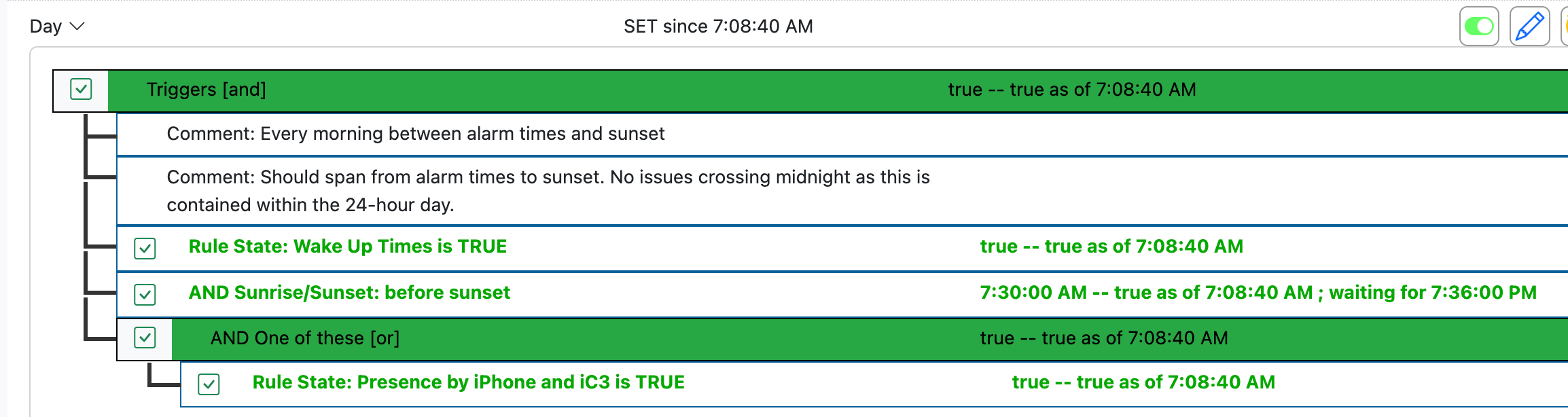

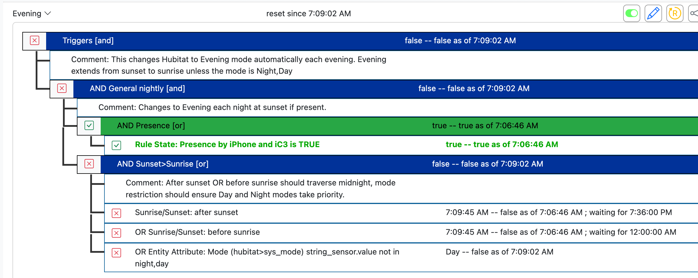

    Been fighting with my Day/Evening/Night modes of late. Thought I had them working just right but after deploying 22251 yesterday evening something "happened." (Note, I've been holding off on reporting what I think is a bug using the sunrise/sunset settings in rules wherein they won't hold a setting until I destroy and recreate that criteria a second time.)
    My rulesets:
    I had to one-eyed add the mode restrictions at midnight after being awakened from a sound sleep.
    I'm trying to keep my rules slim/trim after finding many duplicate/conflicting rulesets during a review over the past few days.
    For Days, I should be present, it should start at 0630 ET each weekday, 0730 ET each weekend day (as sunrise often comes after those times.) No concerns about crossing the "midnight divide" with day.
    For Evenings, I should be present, it should start at sunset and end at sunrise (note: that sunrise thing won't ever happen as one goes to bed at SOME point and invokes night) but I do have the logic in there so the system doesn't switch to day or just get lost at midnight if I'm up late.
    Any thoughts on how to make this cleaner but not be awakened at midnight? lol

      In your Day rule, you have "before sunset" as a condition. That means the test will be true from midnight to sunset, false from sunset to midnight, and then go back to true at midnight, every day. Is that consistent with your intentions? IMO, Day isn't day until after sunrise (i.e. the period between midnight and sunrise isn't Day, it's part of Night to my thinking).
      Oh, and in Evening, your two conditions "after sunset" OR "before sunrise" can be written as a single condition "between sunset and sunrise".

            @toggledbits Ok, this has surfaced the potential bug I referenced in my OP.
            I'm attempting to edit the Evening ruleset to change to "between sunset and sunrise". I add the trigger:
            I click save and exit
            Rule shows as SET
            The trigger has changed to "from sunrise to sunset"
            And now my system is fighting over Day vs Evening.
            EDIT:
            Further, editing the trigger does not prompt for save - it's as though the change in the trigger isn't seen.
            Further testing... adding a new trigger of "after sunset" and clicking save switches to "after sunrise".

                OK. I would have liked to see a bit more concise description in that OP (e.g. "sunrise/sunset selections not saving when edited"), but found and fixed. Another thing you might have observed is when you changed those menus to sunset first and sunrise second, you didn't get the green bar on the left of the condition, indicating that it had been changed.
                I'll do a build later today with the fix. In the meanwhile, you can work around it by changing the sunrise/sunset start and end to what you want, then edit the offset to something and then re-edit and put it back to 0 (or whatever you want). You should get a green bar on the left side of the condition when you do that.
