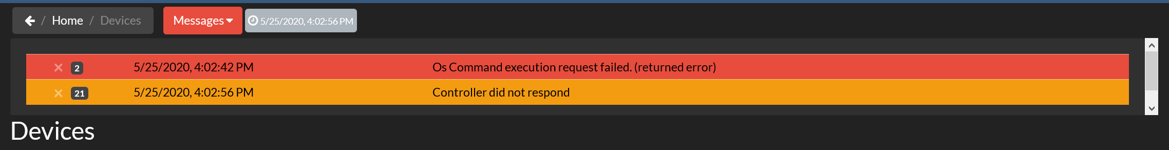

Altui - OS Command execution request (returned error)

    I am used to errors, but never seen this before on altui on vera. keep getting this now all the time, any clue?
      We’re you doing anything special just before then? You must have been doing something in order to have spotted the error message so quickly.
        sender
        wrote on last edited by sender
        I was trying to "replace" a dead nod in the vera interface until I found on a forum 🙂 (which one?) that this button was function less. So I found a tip to go to altui and since then I saw it... rebooting does not get that message away.
        Edit: every thing I want to change and that want a luup reload gives me now this error. Although everything seems to keep working?
          I’m not familiar with Vera logs, but I notice on openLuup that AltUI attempts to delete a files/folder and/or create a directory. It’s possible that this is the cause. In which case, it’s totally benign. Did you upgrade AltUI recently, since it hasn’t always done this.
            sender
            no, no update recently...
              sender
              Is there any location I can look to see "more" on the error? I have this error continuously...
                So when you say 'continuously', you mean that after clearing the red error it comes back? There should (may) be a line in the log which gives further diagnosis. The orange error should only occur when AltUI is unable to connect to the host Vera. Again, it should be clearable.
                  sender
                  Yes, I can clear but it comes back upon doing "anything", changing room, changing names,etc. So I think after luup reloads.
