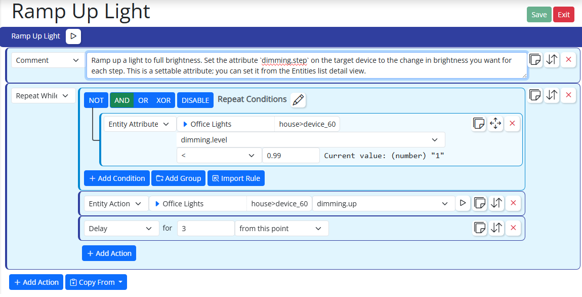

    @toggledbits I am having some difficulty implementing the suggested approach. In my case, what you suggested above worked but with some limitations. Maybe due to the fact that I am not using the Z-Wave controller but Z-Wave JS UI.
    I have created the same rule as you suggested but to better understand what is happening I perform some test from the "Entities" menu.

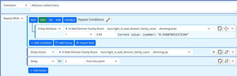

      @gwp1 Here is the screen capture. It is basically a copy of what toggledbits provided. Keep in mind that it is working fine with the default dimming.step and if your dimmer is normally set to 100% before being turned off.
      From the screen capture you can see that, in my case, the "Current value" is 0.59...This is as high as it will go if the previous state of the dimmer was 60%. This situation causes the while to repeat every 2 second indefinitely. I have to kill it in the "running reaction" status screen or to disable the rule.

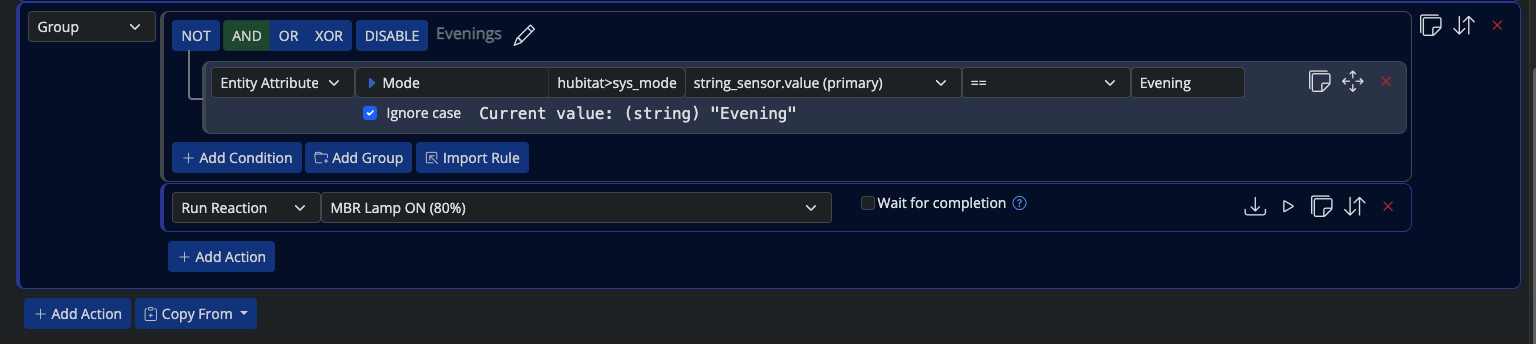

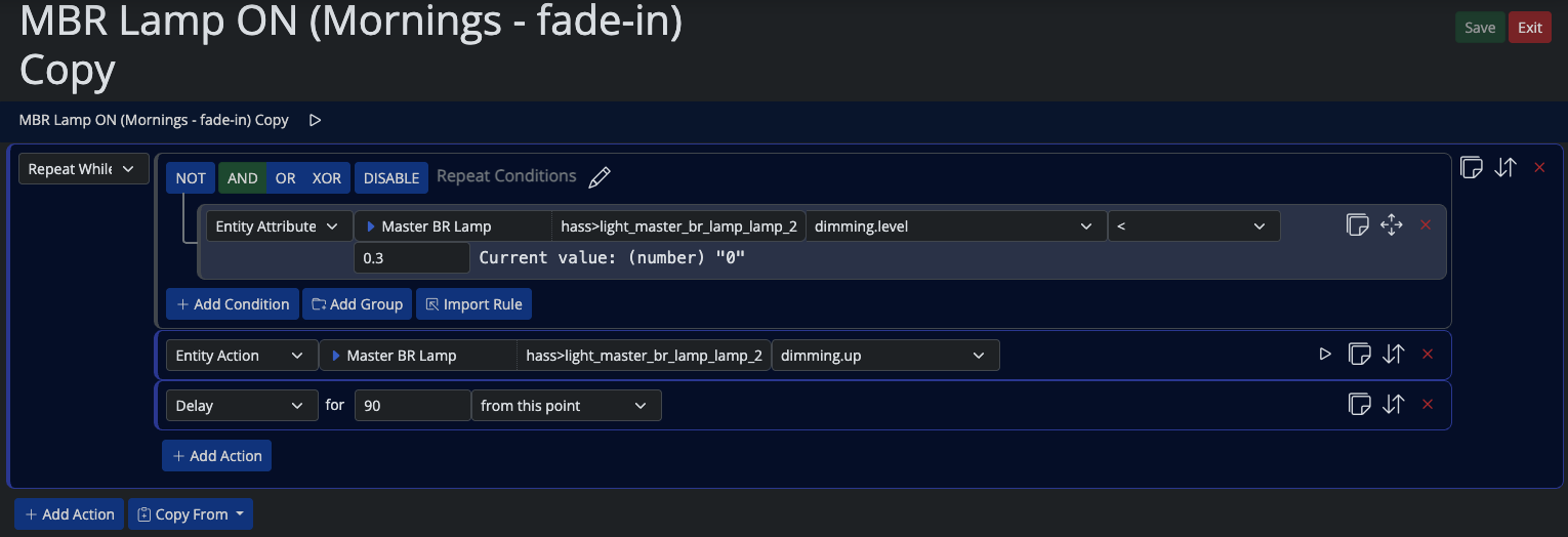

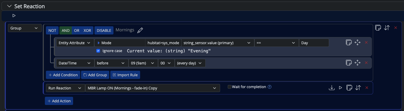

        @vezinpi mine is as such:
        Here's the rule's Set Reaction that pulls this in.
        I also have another group under this same rule's Set Reaction for Evenings.
        Everything I've seen shows this as working as intended. Only rises to 30% in the mornings, 80% at night. Only the mornings get the slow roll ramp up.

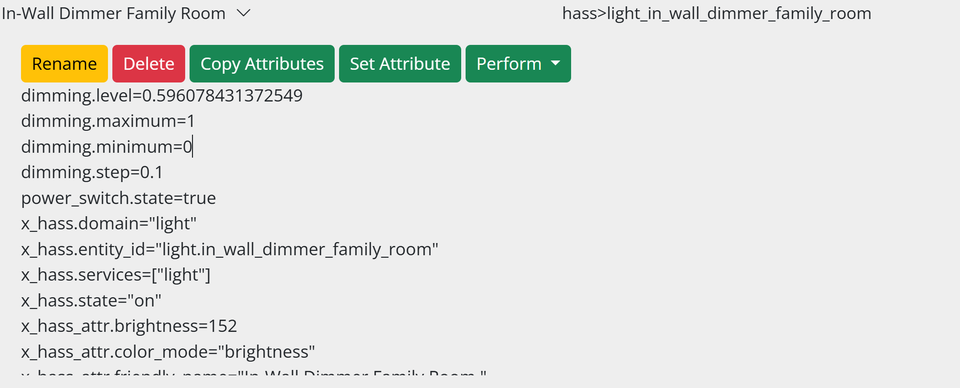

            Hi again, more accurate info for the "Perform dimming.up/down"
            I have just made a test from the entity menu. Using the default dimming.step (0.1) I did the following starting with the dimmer off:
            1- Perform dimming.up 10 times
            This should have brought the dimmer to 100% but it did stop at 60% (0.59...)
            2- Perform dimming.down 10 times
            This should have brought the dimmer to 0% but it did stop at 50%
            From 100%, I can only dimmed.down to 50%
            from 0%, I can only dimmed.up to 60% (0.59)
            The dimming.set "value" works all the time
            Here is the log from Z-Wave JS for the 10x dimming.up followed by the 10x dimming.down test.

              Sounds like you might have dimming.minimum on the entity set to 0.1? And what of dimming.maximum? Failing that, does the device itself have min/max set in its Z-Wave configuration?
              • V Offline
                V Offline
                wrote last edited by
                The dimming.maximum/minimum are set to 1 and 0
                @toggledbits said in Gradually turn on lights.:
                Not sure exactely how to check this. The device is a Zooz ZEN 72. I look in the Z-Wave JS UI and could not find any parameter that would limit the dimming min/max.
                I might be wrong here but it is my understanding that the Z-Wave JS UI sits between HA and the devices. Since the Z-Wave JS UI log shows that any level change request above 60 from MSR, stays at 60, it can only be coming from MSR or HA. In addition the dimming.set works without any issues.
                  OK. There are some rounding issues with JavaScript, and I think I can tune things up to work around them a little better. Stay tuned.
                  Also, tip: use the Copy Attributes button instead of screen-grabbing the attributes. Gives more data.

                        Loaded the new built and as expected, the dimming.up/down are working for all levels. I also noticed that the dimming.level reported are nicely round up to one digit after the "." except for 50% where it displays "0.51" (not really an isssue just reporting what I see)
                        However, the other issue mentionned my opening post (that got kind of forgotten) is still present. Here is the refference:
                        1- The "dimming.step" when changed does not stick after a dimming.up/down
                        In the "Entities" menu I set the attribute "dimming.step" to 0.05. Still in the etities menu, I then perform a "dimming.up" and can confirm that indeed the "dimming.level" went up by 0.05 however at the same time the dimming.step goes back to 0.1 (default). From that point, any subsequent "dimming.up" uses the default.
                        Again, this can wait until your next release if a fix is indeed needed.
                          wrote last edited by toggledbits
                          Have you done a hard refresh on the browser? If that's not it, check file permissions on your storage directory, and also check the logs to see if any errors are emitted when you change the attribute value and within the window of about two minutes after (allowing for the delayed-write strategy caching). The other likely issue is that your storage directory has issues and isn't properly saving the state data for the entity.
                          Edit: Well, I said:
                          There is no code that changes dimming.step other than the button you use on the UI.
                          And that's technically true, there's no code, but... seems there is a stray directive in the entity mapping data table hass_devices.yaml, which is specific to HassController, left over from wayyyyy long ago that should not be there today, and will do what you are observing. Simple fix. I'll roll a new docker image shortly.
                          Edit 2: Updated container is up and ready.
                          • V Offline
                            V Offline
                            As usual, you nailed it!
                            With a dimming.step of 0.03, it does a very nice gradation.
                            Many thanks
