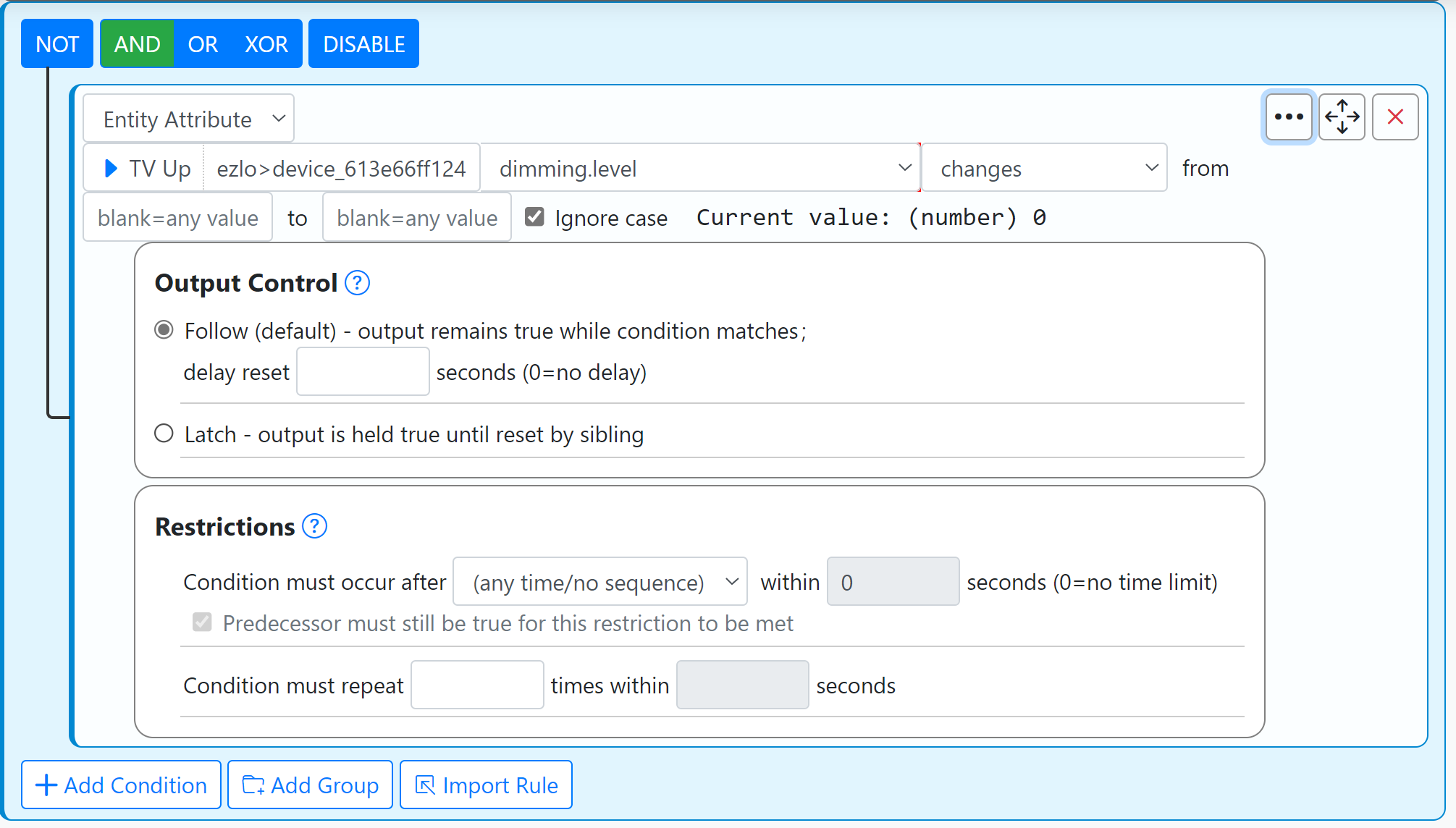

                          Here's the general structure of the conditions. Notice there's a group with "NOT" set to invert the sense of changes in the only condition the group has.
                          There are condition options applied to the group (not the changes condition):
                          When this group goes true, it means the dimmer has not changed for 3 seconds, the rule sets, and your Set reaction should copy the value to the other device.

                            This seems to work and stops the race condition, and there is no delay in reaponse from other device.
                            biuld the same rule for the other device. Both set the global expression dimming to 1 to stop the other reacting , and feeding back
                            Screenshot_20210914-184140.png Screenshot_20210914-184237.png Screenshot_20210914-184311.png Screenshot_20210914-185552.png
