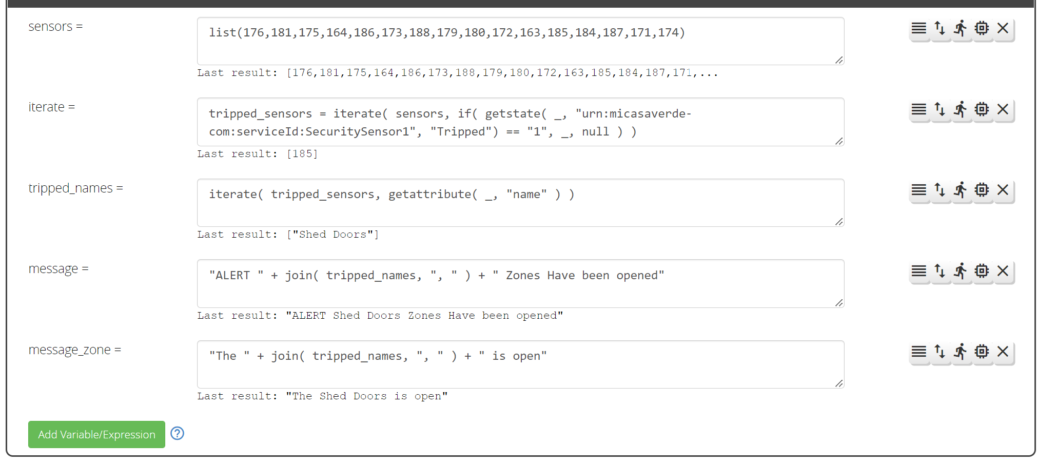

    Hello all, on Reactor Vera I had a few expressions built (with the help of some of you guys) that basically listed all security sensors and then from that list, another expression listed the sensors that were tripped. Attached is a screenshot of that.

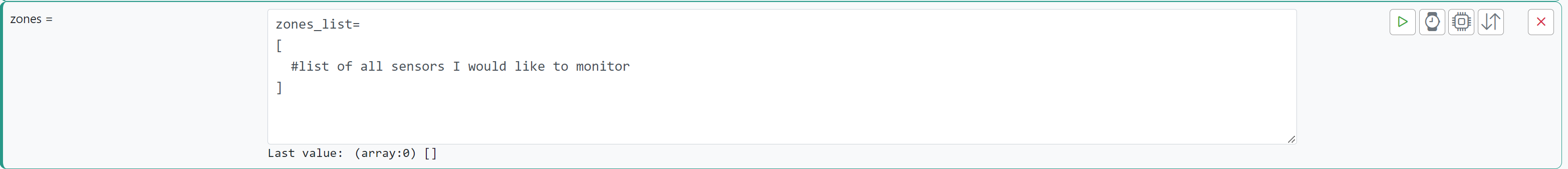

    I want to recreate those same expressions and have really only gotten as far as being able to list all the sensors as an array and since MSR expressions are not like Vera Reactors expressions I am a bit stuck. I basically need help creating an expression that will check the binary_sensor.state and if its true create spit out its entity name, and if false null. After that I think I should be able to create a message expression in similar fashion to the Vera expression.

      This thread.is a pretty good starting point. It covers a straight line approach to what you want to do. There are some enhancements available since that thread (like DynamicGroupController), but those are more advanced topics, so for this first step, stick to the basic way described in the post, which is pretty much the same as R4V, just with the updated syntax.
      Also, be sure to check out the Expression documentation for some additional clarity on the updated expression syntax. I think the bulk of the changes are not in the language itself (but there are adjustments, for sure), but mostly in the function library.
        Perfect was basically able to copy paste your solution and tweak it a bit to work. Attached is the screenshot for anyone's future reference! Screenshot 2022-09-06 125702.png

                Having some issues with the expression that determines what zones are true. It was working when I originally created the expression but I made a few tweaks to expression names and now it doesn't work. Here is a snippet of the logs. Also a screenshot of the expression 6b193d6f-8e18-447e-a032-ef5e5e4b9e18-image.png
                [latest-22248]2022-09-06T23:41:57.638Z <Rule:INFO> Zone Open ALERT (Rule#rule-grpot1ehov) evaluation complete
                [latest-22248]2022-09-06T23:41:57.639Z <Rule:INFO> Babay/Papa Windows (Rule#rule-l7jasakd) starting evaluation; because entity-changed Entity#hass>binary_sensor_babay_papa_windows
                [latest-22248]2022-09-06T23:41:57.639Z <Rule:INFO> Zone Open ALERT (Rule#rule-grpot1ehov) starting evaluation; because entity-changed Entity#hass>binary_sensor_babay_papa_windows
                [latest-22248]2022-09-06T23:41:57.640Z <Rule:INFO> Babay/Papa Windows (Rule#rule-l7jasakd) evaluated; trigger state unchanged (false); rule state remains RESET
                [latest-22248]2022-09-06T23:41:57.640Z <Rule:INFO> Zone Open ALERT (Rule#rule-grpot1ehov) evaluated; trigger state unchanged (false); rule state remains RESET
                [latest-22248]2022-09-06T23:41:57.640Z <Rule:INFO> Babay/Papa Windows (Rule#rule-l7jasakd) evaluation complete
                [latest-22248]2022-09-06T23:41:57.641Z <Rule:INFO> Zone Open ALERT (Rule#rule-grpot1ehov) evaluation complete
                [latest-22248]2022-09-06T23:41:57.641Z <Engine:ERR> [Engine]Engine#1: error evaluating expression tripped_zones: [ReferenceError]ReferenceError: Invalid scope in reference to member binary_sensor of (object)null
                [latest-22248]2022-09-06T23:41:57.642Z <Engine:ERR> [Engine]Engine#1: expression: each id in zones_list: getEntity(id).attribute.binary_sensor.state == "true" ? id : null
                [latest-22248]2022-09-06T23:41:57.642Z <Engine:CRIT> ReferenceError: Invalid scope in reference to member binary_sensor of (object)null
                    at _run (/home/armans2/reactor/common/lexp.js:1490:31)
                    at _run (/home/armans2/reactor/common/lexp.js:1484:33)
                    at _run (/home/armans2/reactor/common/lexp.js:1334:34)
                    at _run (/home/armans2/reactor/common/lexp.js:1502:32)
                    at _run (/home/armans2/reactor/common/lexp.js:1594:41)
                    at /home/armans2/reactor/common/lexp.js:1324:29
                    at _run (/home/armans2/reactor/common/lexp.js:1323:28)
                    at run (/home/armans2/reactor/common/lexp.js:1704:22)
                    at Object.evaluate (/home/armans2/reactor/common/lexp.js:1740:20)

                  Interestingly enough I am using almost the exact same expression elsewhere just fine Screenshot 2022-09-06 170412.png
                  wmarcolinW 1 Reply Last reply
                    You're right... it is almost the exact same expression... almost. (I'm teaching here... look closely at the one the works, and the one that doesn't).

                        It would be my preference that Pabla find his error, since the way he's doing it will work... worked before, and he said that, he just changed something that made it not work, and some troubleshooting is necessary. In this case, a "code review" is sufficient (a review of the failing expression, perhaps in conjunction with a careful comparison to the working similar expression).
                          @toggledbits said in Create Expression to call out Entity ID of Tripped Binary Sensor:
                          Had a feeling it was a typo mistake, gonna take a look with some fresh eyes later today.

                                wrote on last edited by Pabla
                                okay so I checked and noticed that I wrote attribute singular and in the working one made it attributes plural. Still no success.. I even got someone else to check the syntax and they weren't able to find a difference between the working and non-working expression.
                                I fear I am overlooking something super basic which I thought I fixed but I have yet to find the error
                                Edit: I had a typo in my array of entities all is well
                                  Did the behavior change? If so, what does the new behavior look like? If not, what is in the logs?
                                  PablaP 1 Reply Last reply
                                    @toggledbits it works as expected now, I had a typo in one of my entities in the array.
