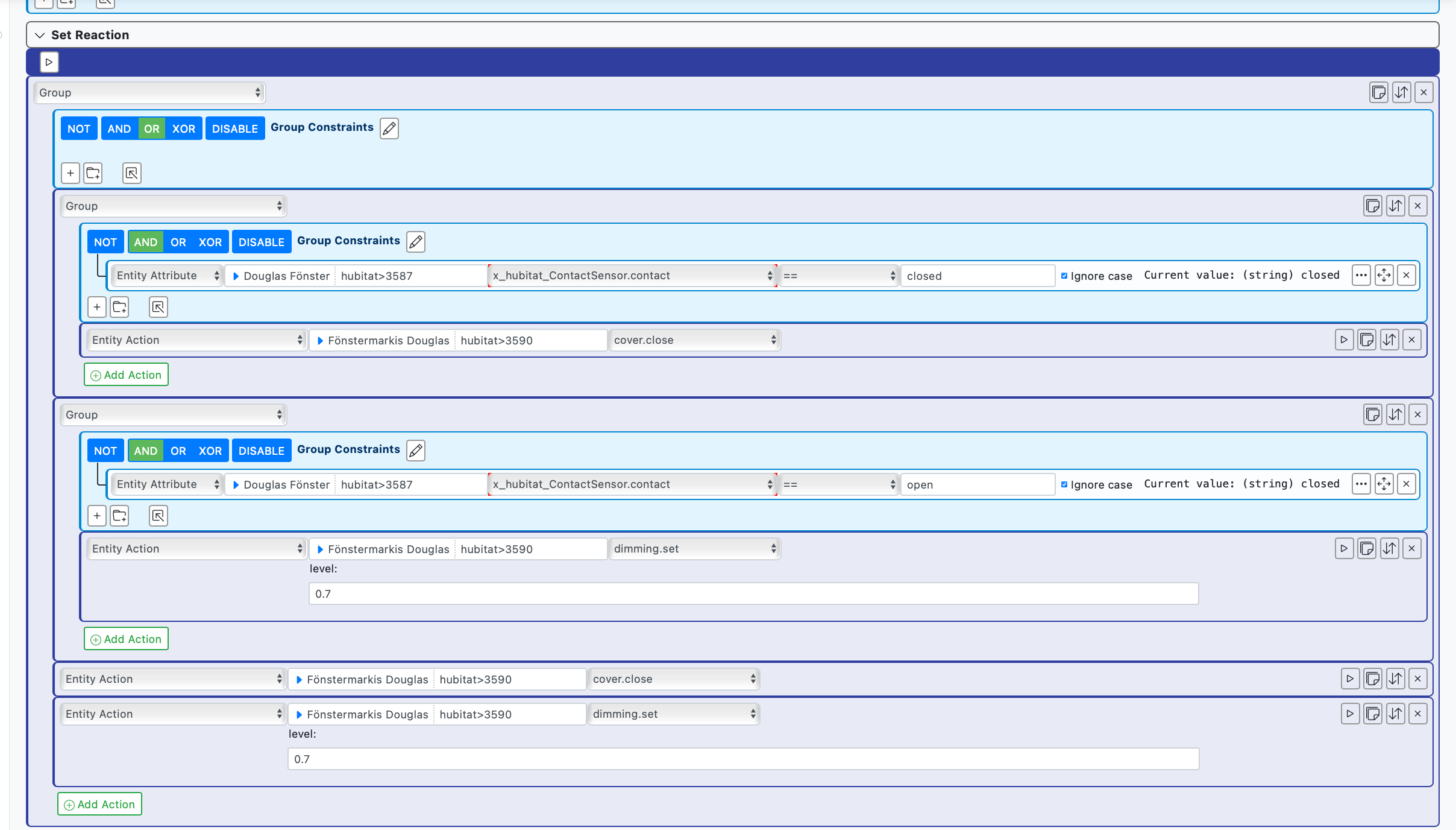

    Hi .... Is this reaction made right?
    When I reload reaction the 2entity actions at the bottom is popping up. I erase them but when I reload the reaction they come back...
    I want my shade to go close if window is closed and if open it should go to 70% (0.7).
    /Mattias!Skärmavbild 2021-05-13 kl. 07.51.11.png

        Matteburk
        ahh, correct wort is Reset , the yellow botton. I save and then go back and reset the rule. I fwill ix a PR for P

          Matteburk
          @librasun I am on latest 30
            I need more detail on the PR you opened. I cannot reproduce your report. When you open a PR, particularly for a UI bug, please document every step you are taking to reproduce the bug.
            M 1 Reply Last reply
              Matteburk
              @toggledbits When reproducing it I think I found out that I have been misunderstanding how u use groups in set reactions.... I think msr puts the entity actions on the bottom because on the first group I have no data. I thought I could have a group with an OR and then 2 subgroups with AND that executes entity actions. But it is 3 groups in the picture and not one group with 2 subgroups.... ?

                Since this is my first time seeing or even contemplating nested Group Constraints (neat idea!), I've got to ask @toggledbits this fundamental question about the pacing of Action execution:
                With this setup in Set Reaction...
                SET REACTION ONE
                [Group Outer] [AND]
                No conditions
                  [Group Inner] [AND]
                    Condition == TRUE
                      Delay=3
                      Action A
                  [end Group Inner]
                Action B
                [end Group Outer]
                ...will MSR perform Action B immediately when Group Inner goes TRUE - thereby triggering Group Outer to TRUE (correct? even though Group Outer has no overt Conditions of its own?) - followed by Action A happening 3 seconds later? Or will MSR attempt to finish executing all of Group Inner's steps first, such that Action A completes followed immediately by Action B?
                I strongly suspect the answer is the first of these alternatives. And that if the user intended the second scenario, they should place Action B as the final step inside of Group Inner.
                  Subgroups are always processed inline, so assuming the inner group's constraints were met, the delay + A would run first, then B.
                    Very helpful to know, and glad I asked! Thanks.
                      By the way, you can observe this on the Status tab as well, as the outer reaction group would show "waiting" status while the inner group was running its delay and action A.
