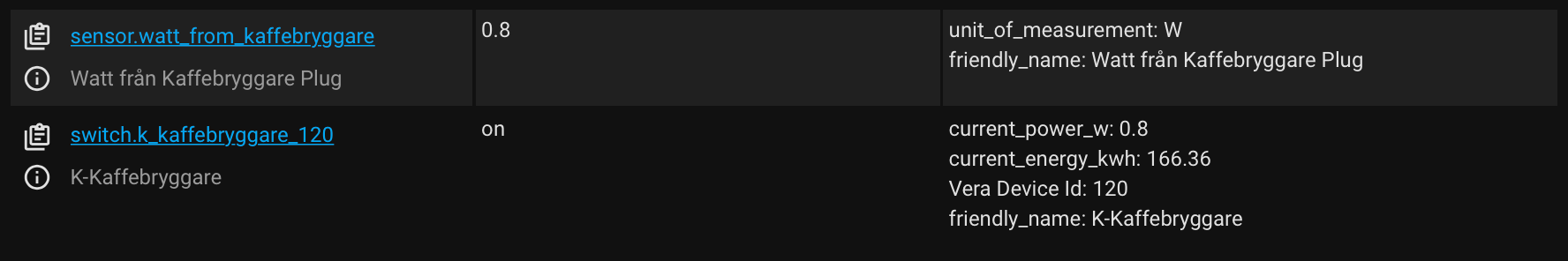

    Relates to Vera integration in Home Assistant
    Just for you to be aware.
    If you are using plugs (or whatever) in Vera to measure energy for your appliances this is deprecated in 2022.4.0 since the HA integration to Vera is not updated and maintained anymore.
    2022.3.8:
    2022.4.3:
    Time to move away from Vera for z-wave ...
    Link to HA thread:
    Apr 8, 2022
    Update 2022.4.0/ Remove energy usage/ VERA
    Yes, it can truly be a hard time to keep up with all the changes and sadly that no one maintains Vera no more. The REST sensor can make it live a bit longer at least for now… sensor: - platform: rest name: "ender_kwh" resource: http://IP_OF_VERA:3480...
      If you're using Reactor (as in your signature), the data is available through VeraController. If you need to get it back into HA, there's MQTTController and other mechanisms.

        I'm feeding my electric meters to HA using mqtt. House one is coming from Vera, solar from shelly em. In both cases I'm not using the official integrations.

          @toggledbits Yes, I am aware of that and this is how I use it with the rules in MSR but for redundancy (and dashboards) I also use the Vera integration in Home Assistant. I have not yet dived into the world of MQTT. 😁
